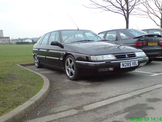

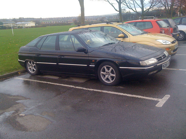

Unless looks matter more to you than comfort be careful what you go for. My old XM was fitted with large alloys when I bought it. It looked good (or so most people said) but the ride and handling were awful, it tugged on the steering wheel when crossing man holes, tram tracks, etc. and on rough surfaces gave a jittery ride but on smooth surfaces floated. Swapping the wheels for a set of Volvo alloys with sensible tyres cured all the problems.
From this -
To this -
Steve.

Unread post by Peter.N. »
Looks much more comfortable 8-)
