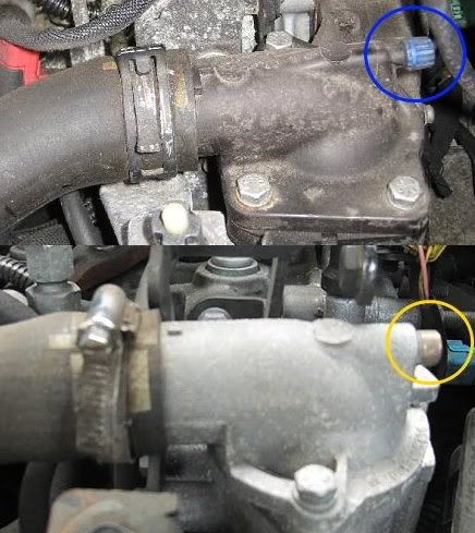

In mine there are two bleed screws:
1. On the bulk head (plastic cap like in a tyre which you have already found)
2. Thermostat housing (allen key hex) as shown in below pic with green arrow.
Xantia MK2 petrol thermostat housing

The two bleed screws should be:-
Heater Matrix outlet - which is the one you found on the bulk head.
Coolant outlet housing - This one should be on the thermostat housing. If you follow your radiator top hoze back to the engine then the bleed screw should be on top of the housing where this top hoze fits.

hi kev
i think i found the thermostat:
here are the pics:
https://picasaweb.google.com/1096236004 ... 9764607618
is it the 'gold' colored allen nut that i need to loosen?
here are the pics:

The gold screw looks like the right one.
You need to bleed until you get a constant stream without air bubbles and you usually get this straight away when the coolant starts to come out.
Tighten the bleed screws and then run the engine until the thermostat opens. Usually manuals say run the engine until the cooling fans come on and off twice.
You can tell when the thermostat opens because this is when your top hoze suddenly becomes hot.
What you need to watch for is the height of your expansion tank relative to your highest bleed point.
On my C5 I undo the fixings for my expansion tank and lift it as high as possible. Try to lift your expansion tank. If it's not high enough you'll still have air in the system.
When the fans have run twice let it cool down then top up the level to the mark.

I have checked the pic in your link and it is clear that your's also have an allen nut like mine
Edit: I have added both types in above pic, lower one is from your car.
... but also I found a pic of a diesel xsara where the '2nd bleed screw' is like a dust capeurotrotter wrote:... , i heard that the 2nd bleed screw is another dust cap or a like a bottle cap, ...

the problem is resolved, no more air and temperature has stabilised at 80, BUT nowi have a new problem, u will not believe this but i managed to snap the head off the gold allen screw
im freaked now at myself for being so stupid
iis there a tool i can get to drill out the screw or should i just get a new piece?
thanks for your help so far
