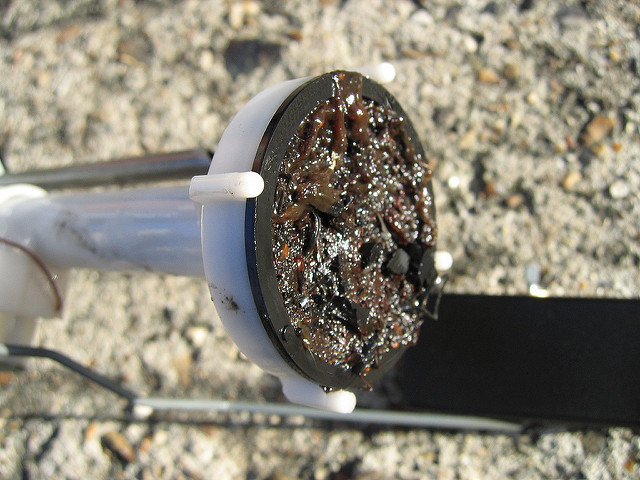

I have just taken the fuel filter out and to describe it as 'mashed' is an understatement!
I have taken a video of it and will upload it to YouTube later for anyone who is interested.
There is lots of some gunk at the base of the fuel filter housing and can only be described as like tooth tartar but brown. Feels almost gritty.

Probably a lot of dirt from the tank pulled through by the thicker fuel, definitely check the mesh on the fuel sender.
Fuel filter wise, I've seen 2 types for the xantia, the type halfords sell with a metal plate on the base and visible filter paper all around, fuel is sucked through the paper into the base then up through the central shaft. This is the type to go for.
The one to avoid is basically a large tube with a holey top that sucks fuel up through it, it's made of plastic and the filter paper is held in with a bead of glue around the bottom.
The glue breaks down, the filter paper swells and expands which in turn deforms the tube locking it in the filter housing.

Is the gunk anything like the mess that's on the gauze on the picture of a diesel tank pick-up?Rhothgar wrote:There is lots of some gunk at the base of the fuel filter housing and can only be described as like tooth tartar but brown. Feels almost gritty.
