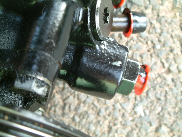

HDI
Posts: 1468
Joined: 22 Sep 2009, 15:46
x 7
Unread post by HDI »
For those that may be interested, this is a picture showing the hairline crack in the HP pump, look to the left of the hex headed connection :-
