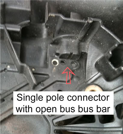

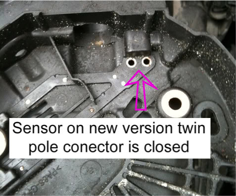

It was the Valeo alternator 80amp, after changing the battery and the problem persisted, I got hold of a 2nd hand Valeo alternator from my local scrap yard £42 inc Vat, went back a happy teddy to put it on the car only to find out the back plates are different I thought I would have to return to the scrap yard, the back plate of the one I got was made 06 and had connectors that were different than mine, the main cable was the same but the signal cable was now a twin pin push plug.
After removing the cover I found the only visible difference inside was that the sensor connector in the new cap was covered
The one that had was an open connector to a single pole sensor,
so to solve all I did was change the end plates over and bingo, no more flickering lights, no more rouge messages about charging fault and abs or punctures.
