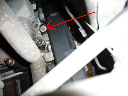

I laughed at this picture:
On RHD cars that is obscured by the seering gear, and on later cars the water feed pipe to the EGR system, and is removed only be feel from above....it took me a moment or two to realise why it was so accessible in that picture
I've added the link to my handy hints write up.
