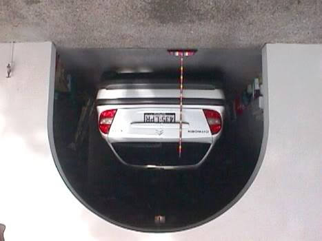

2003 C5 Mk I petrol 4 cylinders.
The C5 wheels are perfectly centred in the arches at correct height.
Car in garage and pump just corrected front height after opening door.
Median readings with left-to-right difference of 3 mm at front, and 5 mm at rear.
Tyre pressure is 33 Psi on all four.
Front tyres 195/65/15
Ground to top edge of front arch: 69.5 cm
Rear tyres are baldies 195/65/15
Ground to top edge of rear arch: 68.3 cm

remember to allow for clogzz car being upside down

Checked today, and all OK within sensible limits (I was surprised how much difference tyre pressure made - 0.15 Bar = 8mm height).
John - I tried measuring from the sky down, but my tape was too short.
Cachaciero - thanks for the reminder, mine are 15" though.
Oops ! I should have mentioned that back then. :oops:
