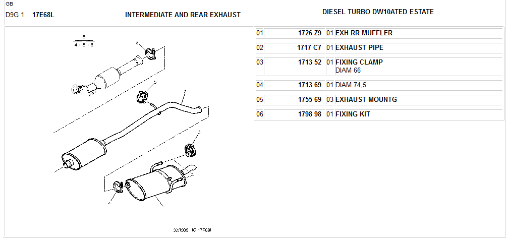

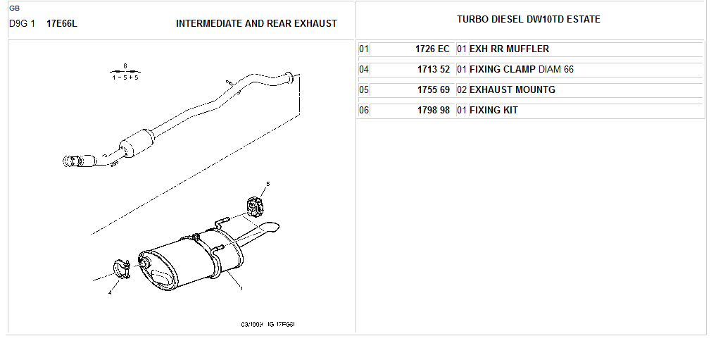

There are probably repair sections now (as the early 206's had this too)
The 'difference' is the DW10TD Estate has the cat and the middle as one pipe (ie the exhaust system is just two parts with no centre box)
The DW10ATED has three parts (cat / middle / back)
I thought about this again, and I don't think that's the difference between the 90 and the 110, although that might be their confusion.
Pics might help better ?, both of these are from the estate: :)

Unread post by Peter.N. »
Hi Andy
Thanks for the illustrations, mine has a join with a clamp behind the cat, then the box and a long pipe to the rear box with another clamp, that's where mine has gone. There is a repair pipe advertised but its only for the 90 bhp so I assume it has a smaller bore.
