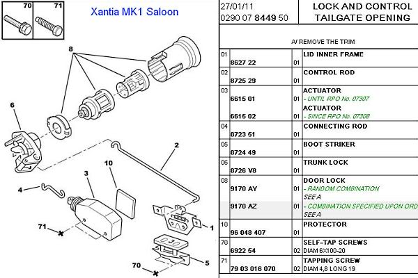

The tailgate lock actuator which is seen in the picture (above link) was very noisy any it didn't function in mine.
Attn.: It is welded (I guess ultrasonic welding) and it is not possible to attach covers once it is opened.
My replacement actuator still works fine.
As spider already said, you can get into the boot, by folding rear seats, just like in Estate models.
Edit: If any help from this pic. :roll: Xantia MK1 Saloon Lock Mechanism:
#3 is the actuator which would be the source of the noise.

Roger, once you are in the boot area, you can pierce the boot trim with a very small screwdriver about 30-40mm above the boot floor and slightly to the right of the centreline, say 15mm. If you then push the blade to the left, it will click on the pull mechanism for the lock, and le voila! the door will open. This allows you to get at the trim and remove it to check the solenoid operation.
I'll check on the parts listing for you for the solenoid, but you need to ensure it is faulty and it is not a connectivity problem first.
