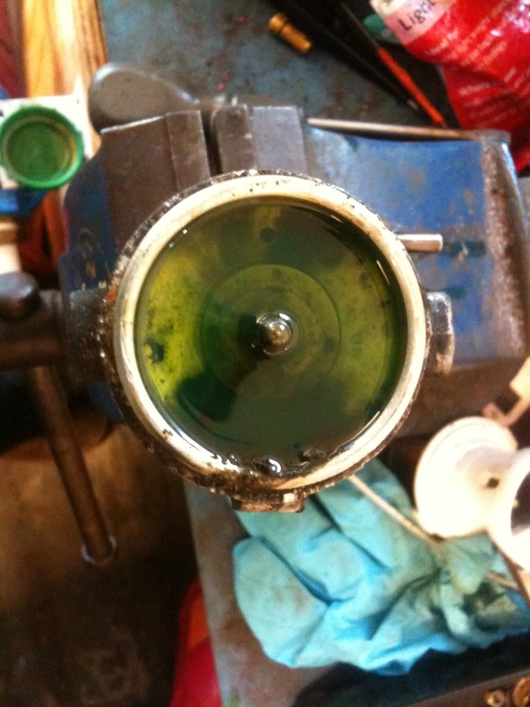

Thanks for the guide, me and my dad attacked mine this evening, check out the picture below, absolutely disgusting! I don't know if you want to use this photo as your 'bad case'?

This was before we soaked up the excess LHM:

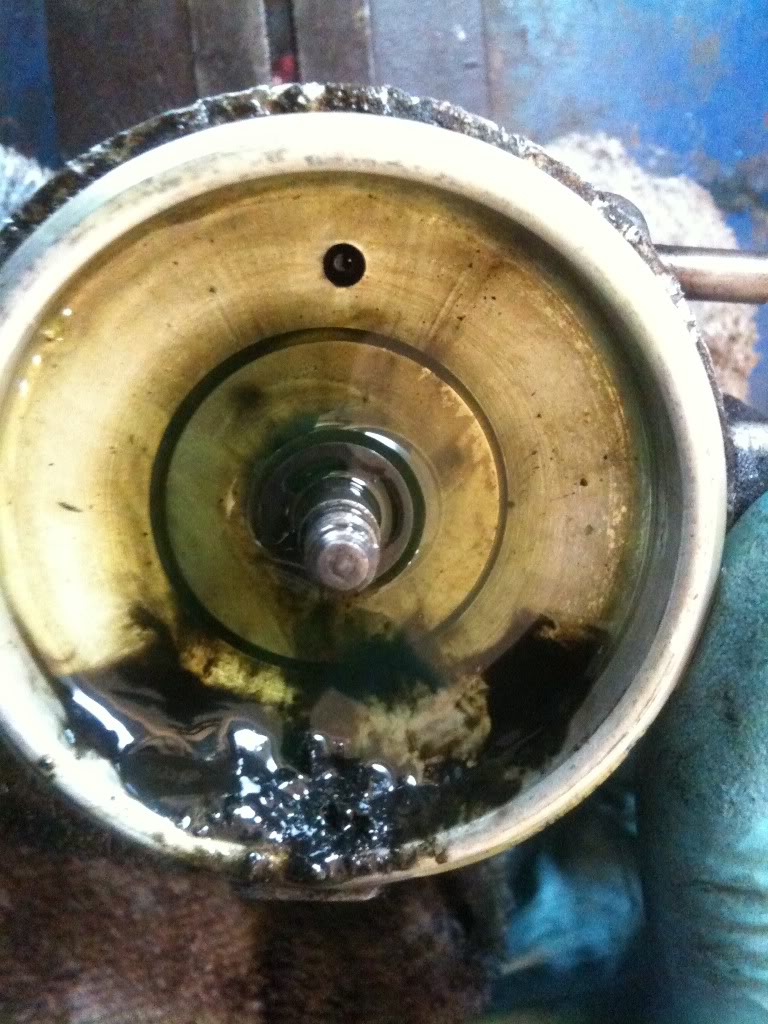

And this was after we'd soaked up most of the excess LHM - niice..
