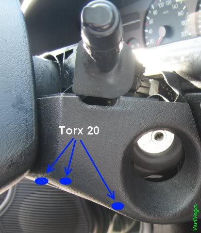

Do I need to remove the steering wheel to remove the indicator stalk asking here will save me messing around, many thanks in advance

Yes, on SERIES 1 Cars, because the cowling wont come off with the wheel in the way..
SERIES 2 cars, the cowling comes off with the steering still in place... however, off the top of my head with the steering at 45 deg I cannot remember if this exposes the two T10 screws holding the stalk in place.
Either car: The indicator stalk is held in by TWO T10 Torx head screws...

Xantia II series:
As citroenxm told, "The indicator stalk is held in by TWO T10 Torx head screws... "

That's true, I have taken the above pic. during wiper stalk change.citroenxm wrote:By the way... Series 1 Horn is ON the Stalk... Series 2 are on the Steering wheel Air Bag....
In mine the horn electric contacts were corroded badly and I guess the horn itself was also suffering of corrosion.
