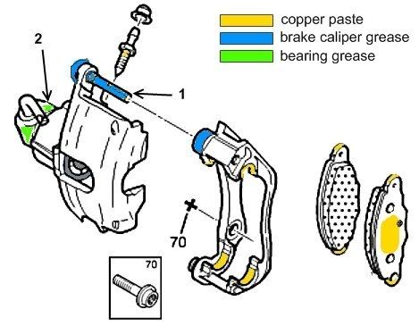

Re: Car shakes / vibrates while braking. Any help pls?
According to the topic "Car shakes / vibrates while braking" and above quote symptoms,superiorzbg wrote:Hi, My car vibrates at around 80kms and also the break pedal pulsate a bit.
Also I have noticed that when pulling the handbrake at 80kms, it will increase the vibration and makes the car shakes.
...l
I would suggest that the brake caliper might be the reason.
Solution: apply brake caliper grease.
Here's a pic which I posted in another thread ( #1 is the caliper):
