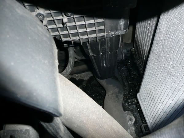

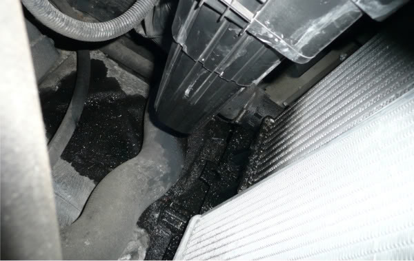

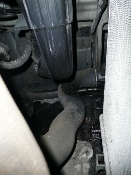

Here are a few pictures of the leak:

Posts: 54989
x 8321
Sid,
That's exactly and precisely where yours is leaking isn't it?
It'll be intriguing to find the cause of it...
It's got to be a small leak. It needn't be a biggie at all as there's always an oily mist in the intercooler and that'll find it's way out of the tiniest hole...

I think it is a minor leak, probably as a result of a whole in the intercooler or pipework. I just wasn't sure if this quantity of oil should be lingering in the intercooler?
Ill have a closer inspection and clean it up so i can see where its coming from.

Indeed Jim, that looks almost exactly like mine, although mines fairly oily there doesn't seem to be much actively coming out. I briefly asked B&L today about it, they seemed to indicate its fairly common occurrence not a lot to worry about, although the intercooler will probably need replacing at some point. I guess if yours has started to cause issues Chris its time for a replacement.

There is a gasket between the plastic end tanks and the aluminium core on these factory intercoolers. This looks like a classic case of either the gasket failing or the end tank starting to come adrift; it's only crimped onto the core, and the crimping loosens over time.
The amount of oil evident in the photos is not excessive imho, but yes, you should renew as it'll only get worse and then you will lose boost.
