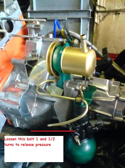

not saying you should do this 'get out clause' in case you burn your car or run yourself over :) but it is what I have done in the past without either event ocurring other basics :) make sure you are nowhere near moving pulleys or have loose tools near them or that can short across the car's battery.
make sure the car is in park :)
ignition off
loosen pressure regulator (different on autos) you will get the gist from the picture. this is to stop the LHM being sprayed everywhere (if there are leaks ) while you are trying to get the car running once it is running you can nip the bolt back up and check the integrity of the hydraulic sytem.
near the battery positive pole, there will (should) be thinner cable going to the starter soleniod 'it should follow the thick starter cable' This can be used to turn the starter 'ignition off' without triggering the fuel / igniton circuit. un connect the spade terminal and hold the 'from the engine side' on the positive terminal of the battery. give it a few seconds at at time, don't labour it :) check there is oil on the rockers arms by opening the oil filler cap an looking in there, don't just rely on the oil light going out
CX's turn over slowly 'very slowly' if the starter is on its way or the battery is down.

Hi everyone, :D
Thank you all for so much support and advice,
Just to clarify the car is a CX 2.5 ie auto pallas series 1 (saloon).
All cars this age have their story, so I'll give you the background to this one. The car belonged to my wife's first husband, Mike, who sadly passed away last summer after a long battle with cancer. Mike really loved Citroens and at one point had 2 XM's and 2 CX's! He owned this since 1986, he was the second owner. The car has been soaked in Waxoyl, structually it's sound. There's no rust on either side of the upper rear arches and window area. The car along with enough spares to fill a Transit have been sold to a specialist CX dealer, my part is to get the car started.
Sunday morning,
After removing the old battery, quite a job, we put in a 55ah battery supplied to us by the purchaser. The oil level was OK and also the LHM level which I took to be the small dipstick near the nearside sphere. As was mentioned in your replies I listened for the fuel pump, which seemed to be working. After a few tentative cranks of the starter, I left the engine ro let the oil move round a little. Next, to ease the load on the battery I paralelled our van's 110ah battery. This lifted the cranking speed and after a few more attempts the engine fired and ran as if was started yesterday!
However I'm not out of the woods yet. After running for more than 10 mins the suspension did not rise, even after moving the height adjustment. The power steering did seem to work, but there was no pressure under the footbrake. Also the alternator is not charging, as the warning light is on and the battery terminal voltage drops when the engine is running.
The handbrake does now seem to be working. The engine speed drops slightly when it's 'gear', so I think I should be able to gently drive the car out of the very small garage. The bottom hose on the radiator seemed very cold whilst the top was hot, so their might be a thermostat problem or similar as well!
Thanks again for all your help, Mike would have loved this.
Regards, samjmann.

Ah! A series one 2.5 Pallas IE - a very nice combination that is. We have very recently just sold one with 28,000 miles on it...pic here.
That CXi 250 number would look good on your car...! 8-)
...sounds to me that you may need to loosen the bleed screw on the accumulator sphere (Neil explains it with more detail and a picture above).
This should make the car rise and give power steering.
Franklin

Could be you need to hand prime LHM into the feed pipe into the hydraulic
pump through a cookery small platic funnel. It'll be the fat feed hose running
from the pump to the LHM reservoir - simply unclip the ligarex wire type
connection and pop the hose off the head of the LHM reservoir.
You may need to feed about 1/2 to a litre of fluid as it gulps it into the
pump and keep on top of feeding it. Once it feels like there's a strong draw
you need to pop the fuilled pipe onto the reservoir head and clamp firmly with
a jubilee - course you probably then may have a bit too much LHM in the
system which you can check when the car rises to the maximum ride height.
Then, vent the commonly called bleed bolt screw on the accumulator pictured
with Neil's picture above.
Andrew
