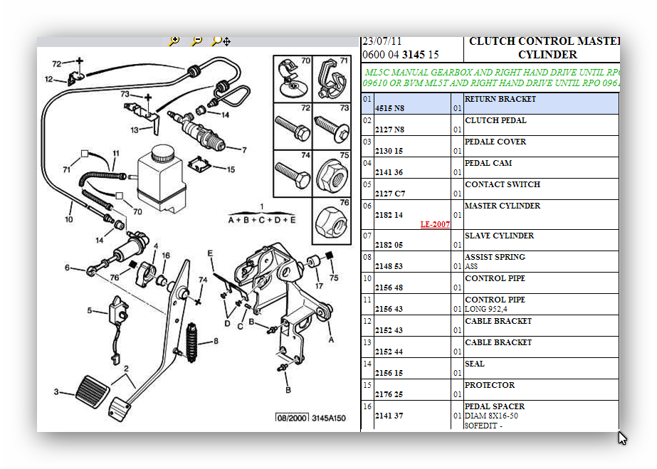

Re: Stiff clutch on C5 HDi...are they all like that?
I wonder if your problem is at the clutch pedal, on the C5 it has a helper spring to make the load lighter, if that is missing or broken you will not have that effect. See item 8 on the picture.
