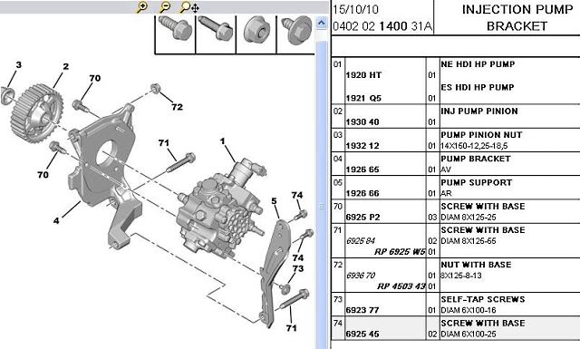

the garage had some diagnostics but not a full system. we are a bit rural where i am and its a long tow to the nearest citroen dealer for a full check. my pocket cant stand main dealer prices either. so i am stuck with trial and error. can the fault codes be obtained without special readers, like toyotas ?
if I give the chassis number can anyone check to see what pumps it has?

its a GB9HWC EURO4G*9HW* VAN
chassis number VF7**************[VIN obfuscated, can be read by forum staff]
hope this helps

It's a Bosch injection system without an electric pump in the tank.
VertVega
Posts: 1178
Joined: 01 Nov 2008, 19:39
x 13
Unread post by VertVega »
crazylegs wrote:... if I give the chassis number can anyone check to see what pumps it has?
Any help from this pic? (Also check your PM)
Don't know much about diesel models :(
