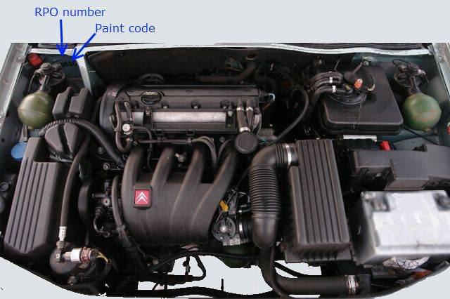

Synergie paint code location is similar as in Xantia, see pic below.
and it should also be seen on the driver's door pillar sticker.

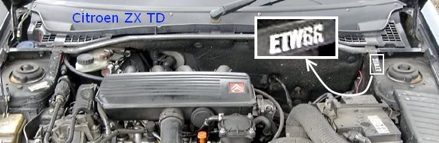

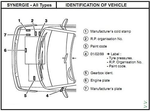

Try to check from this location in engine room. Xsara, ZX and some others have the paint code marked as seen in pic below:
First three letters will be enough to define the paint code.
Edit: Synergie Identification
