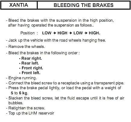

Re: Xantia spheres and Citrobics
Did you check " Supersticky: forum for continually recurring questions" ?Derekofpriory wrote:... I have been going through the topics back to page 40 ...
There's a very informative thread ---> Spheres, Hydraflush and Brake Bleeding
Also I add this pic from a Citroen technical book.
( As a rule of thumb, start from longest physical distance between LHM tank <---> wheel. )
One more comment,
- I use a piece of wood/metal bar for "brake force" (between brake pedal and drivers seat front end).
Adjust the brake force by moving seat forward.
- Donor 2023
QUOTE -Also I add this pic from a Citroën technical book.
Hmmm!
This means Mr. Haynes [once again] 'got it wrong again Dad',
Hmmm!
