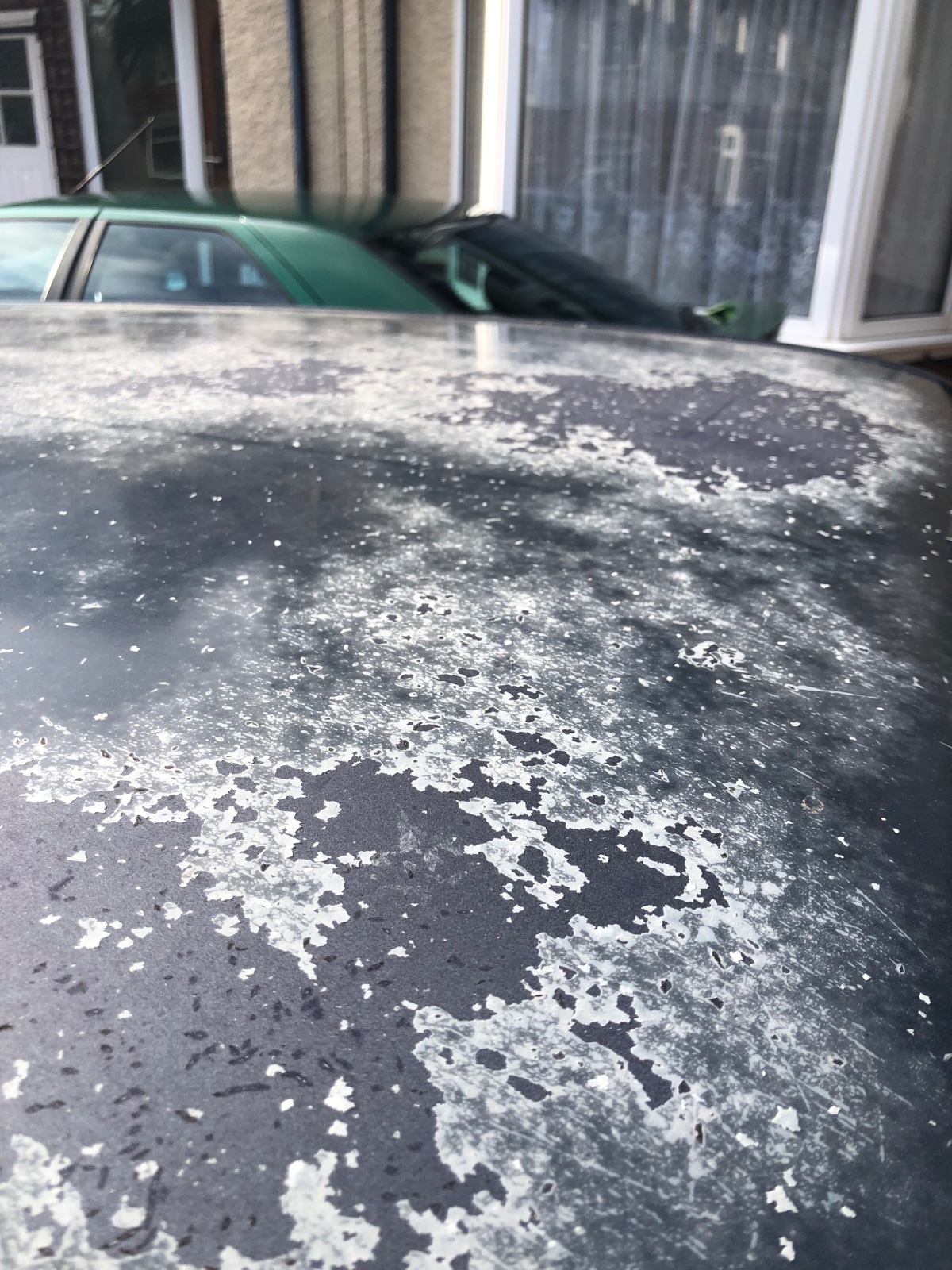

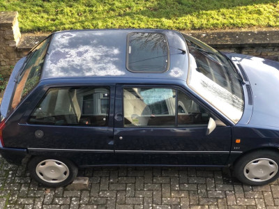

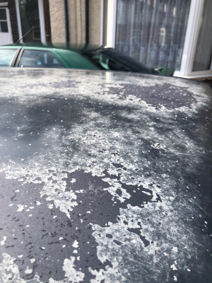

Re: Paint lackure

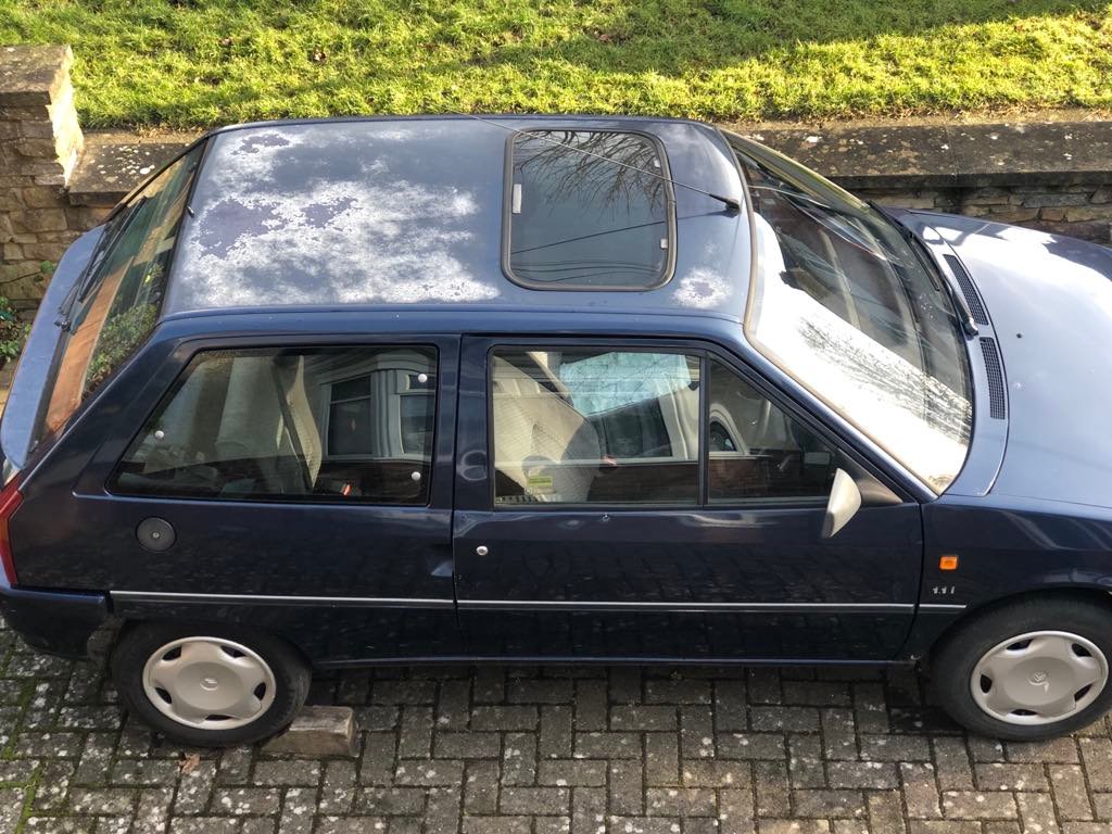

Old thread but seems suitable:
The recent cold weather has really given my sAXo roof…. dandruff lacquer - it was already patchy but the cold spell has really made it brittle so I plan a rattle can touch up after removing all of the lacquer on the roof up to the roof trim, the car isn’t cosmetically pretty but this is a bit too much to bear …..she’s nearly 30 so not too bad ..
Before: I don’t think Head & Shoulders will work, I’m wondering if a ‘gentle’ heat gun session will help finish off the separation of the lacquer …..then a light rub down and see how much base colour is left ….

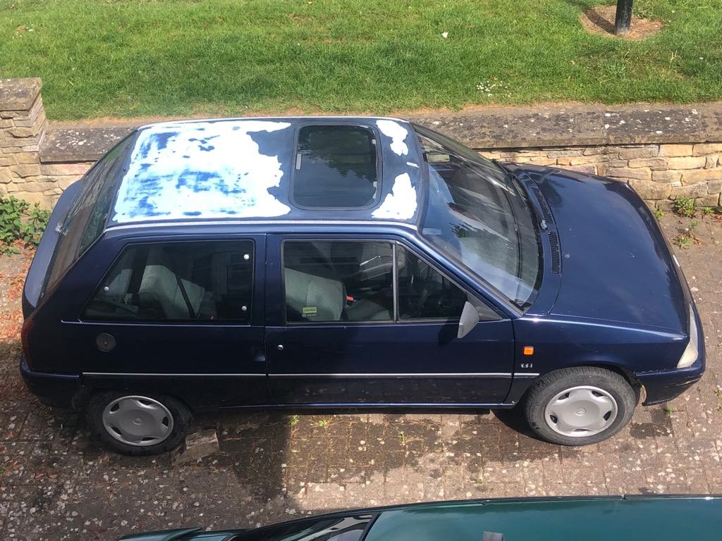

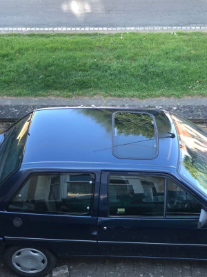

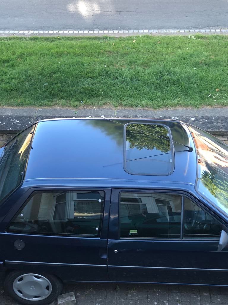

Re: Paint lackure

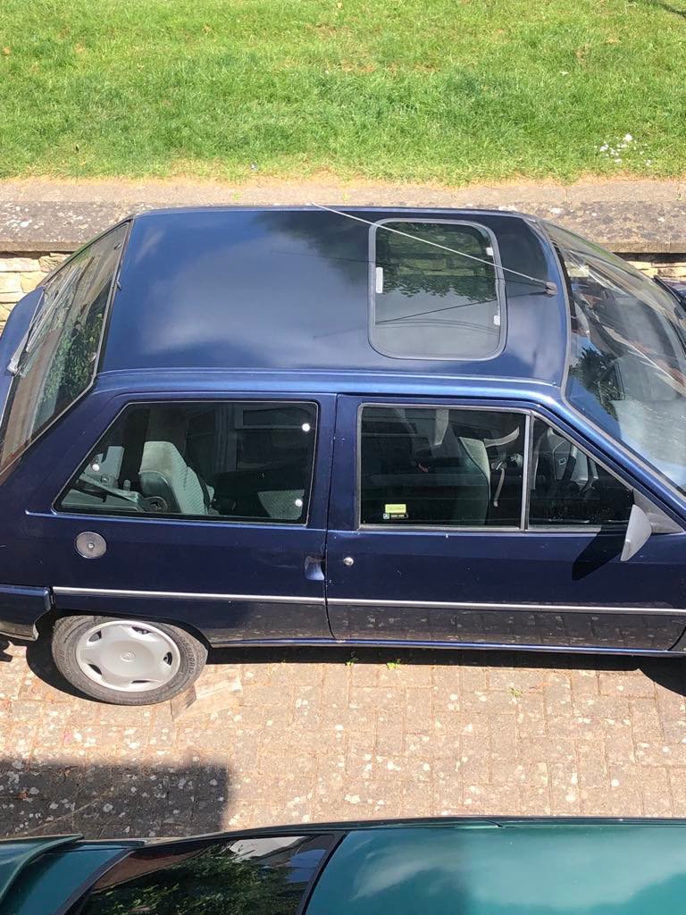

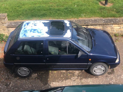

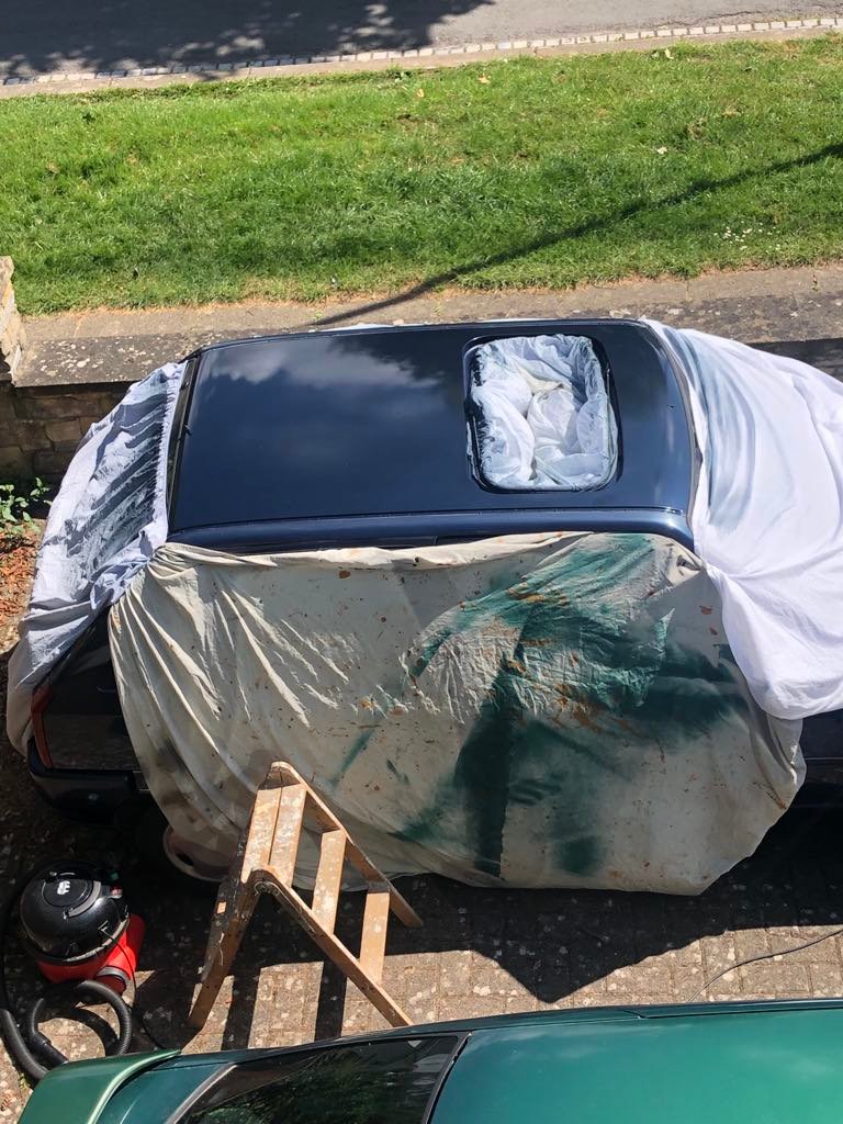

Well I finally got around to doing the job on my sAXo ... I rubbed down to 600 grit and rattle canned it, it's not perfect but WAY better to the casual observer.
Before During Sprayed Result
Not too bad considering the road traffic and a neighbour who decided to mow his lawn just as I started spraying
I'll have to mow it every couple of weeks now
