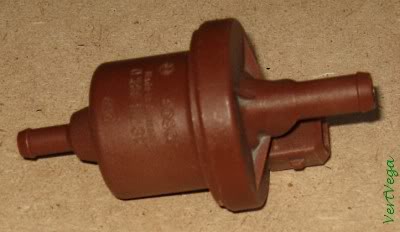

- This might be the depollution canister relay. In a 1.8i 16V, it is almost next to the battery, behind the headlight. You can wrap it with a piece of foam mat.Stepto1 wrote:5. Clicking from under the engine bay. One comes from the top of the engine near the fuel rail. The other comes from the nearside headlight! Sounds like a relay? ...

The relay ticks more frequently and louder when the weather is cold.
You don't have to clean it. It circulates the gases in the system (inj. fuel).
Relay looks like this. In 2.0i 16V it is more hidden than in 1.8i 16V models.
