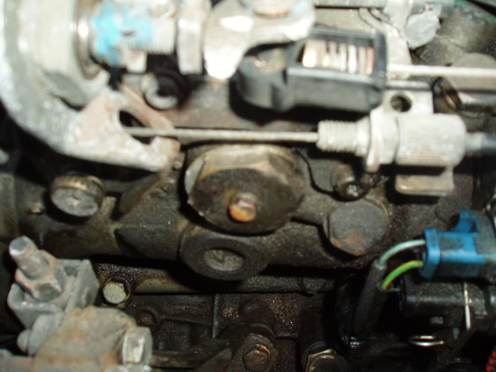

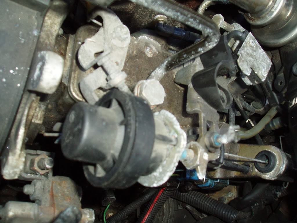

The leak is from the back end of the pump. i.e looking from the inside of the car the left. Its coming between the bracket holding the pump and the pump bady. I have taken pictures but how do I get them online?

I think these may be the photos. my appologies if i've done it wrong

berlingo
Unread post by malshelley »
the forth picyure shows the rear of the pump and the leak seems to start somewhere behind this bracket. If I jam a tissue under the pump between the brackey an pump the leak stops until the tissue is soaked through and no fuel runs under the pump.
is thes where the shaft being discussed is?
