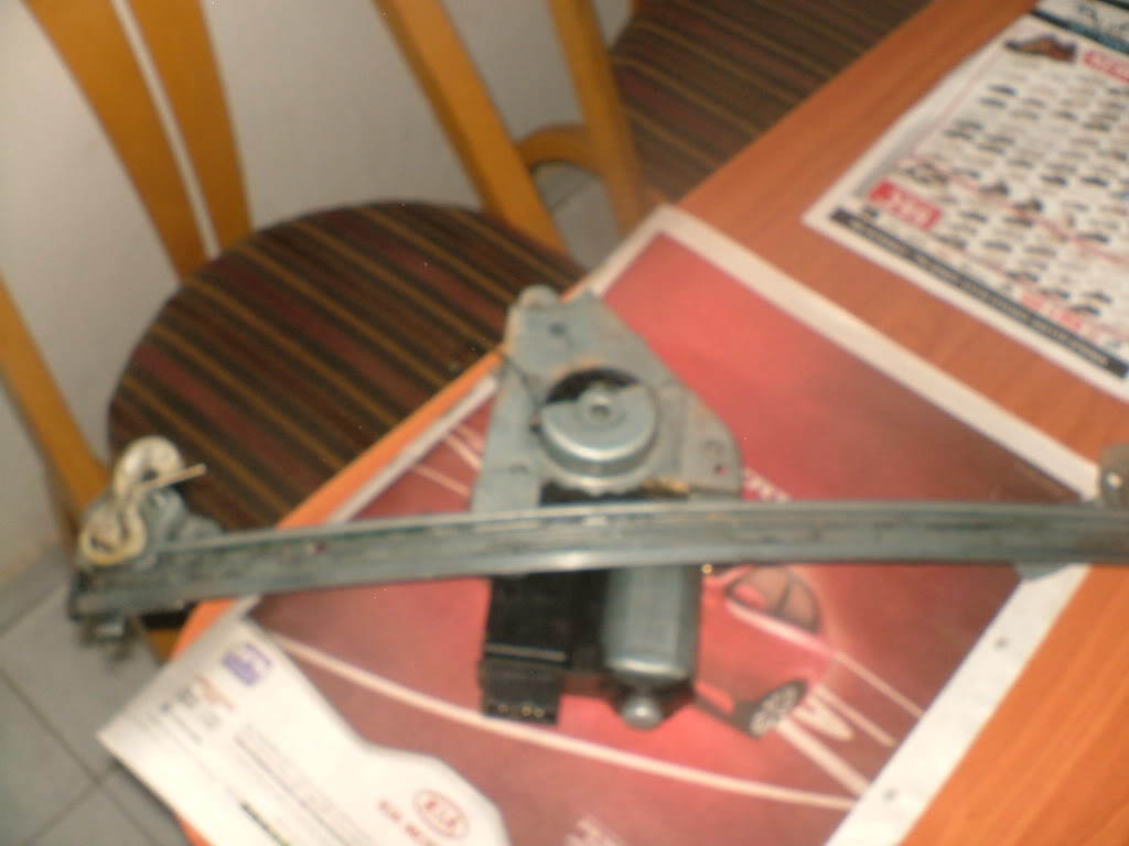

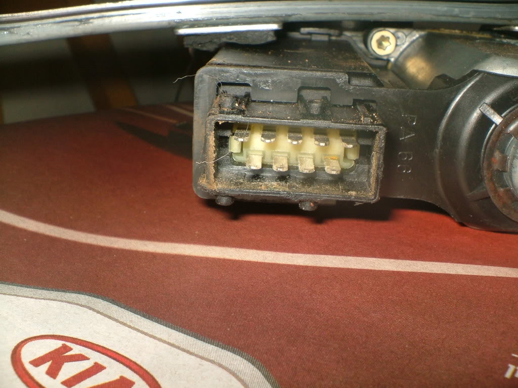

it is the driver's side window (we are driving on the wrong side - lh drive) I think its a 6 pin connector, but I'll check that later and I'll try to upload a pic. I dond believe it's equipped with a pinch mechanisem. I think its manufactured by Bosch. as I said, I'll check later. I have to run to work.

Thanx for your help. I dont know where I can find the VIN no. could you please guide me where it can be found?Image
I've uploaded 2 pics of it, hope that it will help. sorry for the quality.

YES. that does help...
No need for the VIN etc.. Its a One Touch WITH anti Pinch type window winder..
A Passenger unit from a UK EXCLUSIVE ONLY car should help you out there, as they have Anti Pinch ALL Round...
Im sure Ive seen an exclusive on ebay breaking, but its in the UK...
