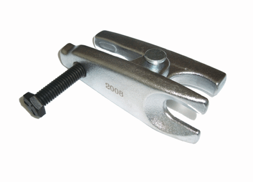

Else that, buy a decent scissor type balljoint splitter
One like this:
Take two 4lb club hammers and strike them each side of the taper housing in a clapping action.
Imagine you're clapping with tow big hammers
Takes a bit of practice though but it can be effective.
One like this:
