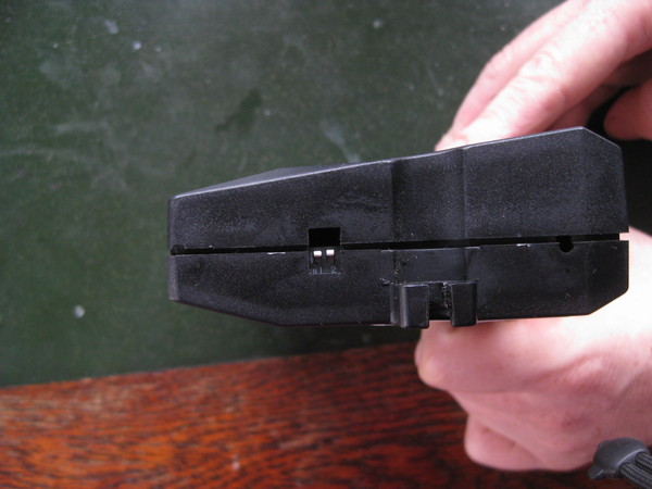

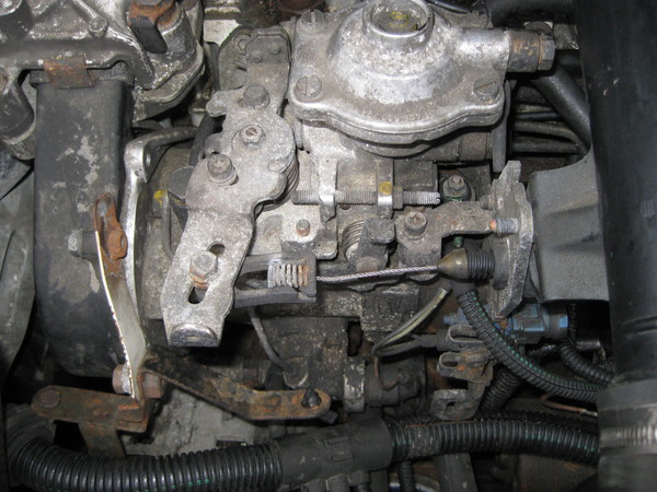

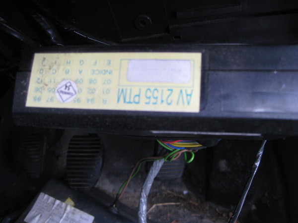

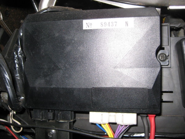

OK, I took some photos and had a look in the car. The injection pump is old enough not to have any magic embedded in it - I can see the stop solenoid connection and unscrew it if I like. This must be true because everything still worked when I swapped engines back in 2005 - if the IP had the codes in it I'd have been knackered.
Turns out I already posted about this alarm system in 2004: http://www.frenchcarforum.co.uk/forum/v ... 9c494aac93
which gives the part numbers and stuff determined at the time (I'd forgotten all that). (I never did get both keys working - we just lived with one key that would start the van).
So - this is the pump:
This is the key:
and this is the alarm box (which has the magic code written on the back):
So, presumably I can get rid of this box and replace it with a simple relay and then it'll just work off the key the way cars used to? It has got 30 wires though, so it'll take me a little while to work it out.
This is the key:

OK, I just spend a very cold couple of hours sorting it out. OK, it's the warmest day for a couple of weeks, but it's still miserable car-fettling weather.
So the reversing light switch circuit thing would work if the ignition switching was already working, but is it isn't that doesn't help at all.
However, it turns out that it was an aftermarket imobiliser so in fact it's a pretty simple matter to simply reconnect the two wires that it severed/diverted (the switched wire from ignition positions 2 and 3), and then just remove the box and all its wiring entirely. Now the key works like a key and I can start the car in less than 2 minutes
This also magically fixes the problem I've had for over 5 years that the 2nd key wouldn't start the car.
Should have done that a long time ago really.
