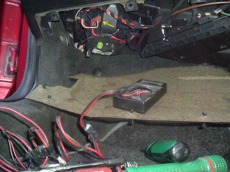

Found the blower motor under the glove box,for some reason I was thinking it would be around/behind the centre console!
Anyway,trusty old 1000 BC multimeter and tools ready,thinking this is gonna be a real p.i.t.ass job..
I unplugged/plugged the blower brown multiplug and the small red and black connectors a few times and hey presto...blower fully working,on all speeds..well I was amazed,thinking, nahh,that's got to be too simple! Haha.
Took the car out and it went off a couple of times,back on when I tapped the said area, so I unplugged again, small file and sandpapered em, bit of WD and some vaseline and so far so good :rock:
Thanks to everyone in those links,within links..there's too many to mention,recall! :P
