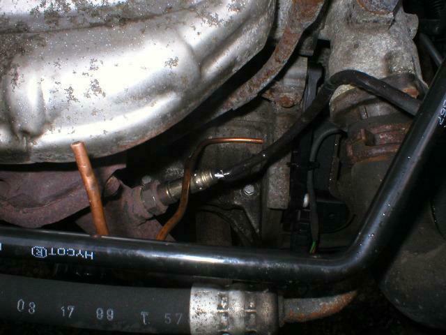

Flywheel is next to clutch. The alignment hole should be at the back of the flywheel. So in his pic, you'd be looking front-on at the engine block, down where transmission joins engine block.

Flywheel is on the Right-hand side of the engine and the pinning boss for the 1.5D is in the same pace as the petrol engine shown in the picture above. Look down by the joint between the engine and gearbox and you'll see it. I used a piece of copper brake pipe to pin the crank as you can see in the picture.
