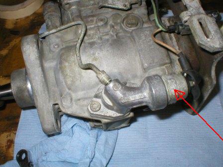

Have a look at the front of the Injection Pump.
If it has a cold start electrovalve that looks like the one in the picture below (pointed to by the red arrow) then it won't have an ECU and will not therefore have an Engine Management Light.
Also, if no ECU, the pump will have a cam-operated microswitch on the top of the throttle spindle.
Another possible way to tell is if the car has no coded keypad. These came along (generally, but not always) with the ECU controlled pump.
Lastly, look at No.3 injector (couning from the flywheel end of the engine). If it has a thin black wire coming out of it, then you have an ECU.
It is also possible it once had an ECU controlled pump and this has been swapped for a non-ECU controlled pump. In which case the EM light would have been disabled.
