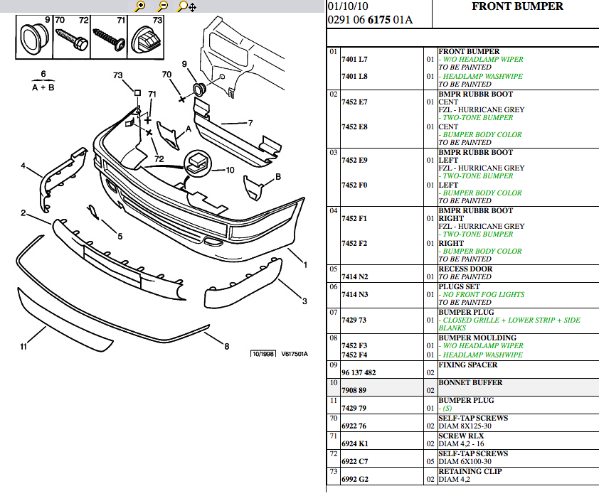

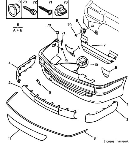

There are 3 or 5 10mm bolts that fix the undershield of the bumper.You will need to remove headlights and indicators along with plastic cover above rad fans (2 small torx screws) and prise the plastic trim out (plastic clips).
Each wheel arch splash guard will need to be removed/pulled to one side and there should be a 13mm bolt running through a bracket into the bumper.On each inner wing approx 2-3 " in there is a small torx screw that holds the wing in.
Then its just a case of giving it a good tug from the front and off it comes :lol: :lol:
If i have this right item 72 is the bolt/screw that holds the bumper and item 71 is the little torx screw
Dont worry about items 2-3-4-8-11 they will stay attatched to the bumper
Hope this helps :)

The visible chrome strips will be different between the two but Citroen do list a difference:
This does show the main BIIIGGG bolts fastening either end on the lower wings
although there are more bolts visible around the grille and lower apron IIRC.

Where could i find parts 2,3 and 4 ...the rubber boots :lol:
Theres nothing on ebay :roll:
1998 Xantia 1.9 TD 186k
2008 C4 grand Picasso exclusive 105k #-o
handyman
Posts: 1116
Joined: 20 May 2003, 18:38
x 2
Unread post by handyman »
Dave, 2, 3 & 4 usually come as pre-assembled onto the bumper body, although they can be taken off a damaged one. Watch out for the moulded clips as they do snap.
