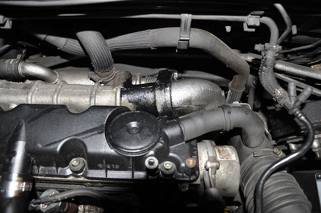

I have a small leak seaping out on the inlet manifold on my 306 hdi (towards the right of the manifold)
I just wondered if there was a gasket that could be replaced?
Also what could cause the oil to seap out of there?

Two issues.............Issue one, is that the turbo oil seals are probably worn and allowing a seapage of oil into the air intake system (which is pressurised by the turbo), and issue two is that the inlet manifold gasket is 'blown' and needs replacing..... the seapage of oil from the leaky turbo seal is highlighting the inlet manifold gasket failure at the point you see the oil escaping from.scfc_151 wrote:I have a small leak seaping out on the inlet manifold on my 306 hdi (towards the right of the manifold)
A small amount of oil passing the turbo seals is allowable, and as long as engine oil consumption is within limits i wouldnt worry about it, i would only replace the inlet manifold gasket asap as you will be down on turbo pressure while it is leaking..

Yes, straightforward job, just make sure the surfaces are perfectly clean on re-assembly.......(mechanics tip......not a bad idea to have the engine 'warm' prior to doing the job during cold weather, kinder to the hands!)scfc_151 wrote:thanks for the reply
Is the inlet manifold gasket an easy job for a diy mechanic?
It looks straight forward enough but any tips?

Ive been looking for a picture on the net to make sure im looking at the correct joint.
Ive had a quick look again tonight and it looks like the seapage is creaping slightly futher.

from the pic it looks more like the joint between the inlet manifold and the elbow rather than between the inlet manifold and cylinder head
which is good because that also looks a lot easier to change than having to take the inlet manifold off.
I'm not familiar with the 90bhp engine, is there a rubber section joining the turbo outlet to that elbow?
might be worth checking or changing that at the same time
