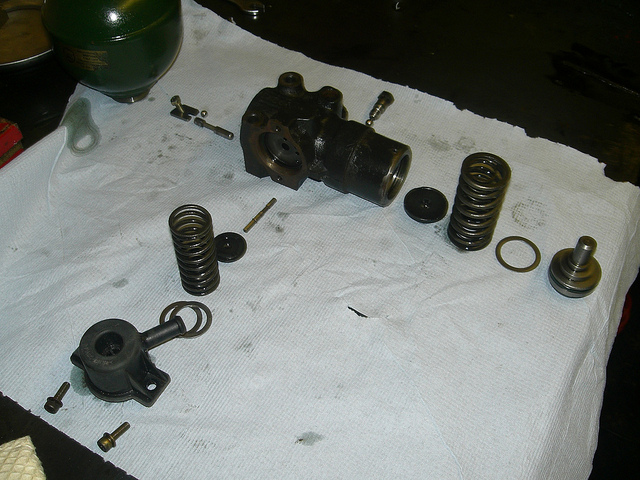

it will either be a loose return pipe, one of three 'o' rings failed, one behind the plastic retainer for the cut out valve, one on the bottom plug that houses the cut in valve or the sphere seal, also as you say the one on the bleed screw.
CIMG3065 by Deanxm, on Flickr
D
XM Prestige PRV6 92
Mitsubishi L200 Trojan 14
Posts: 55223
x 8468
That's a useful picture Dean :D
What's your method for replacing the O ring at the end? Pressing down on that big spring must be a bit fun.
Hydraulic press I guess?

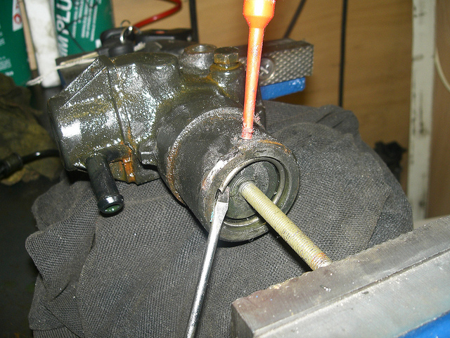

Deanxm
Posts: 3327
Joined: 18 Dec 2008, 17:57
x 87
Unread post by Deanxm »
nope, the spring is a pussy cat,
CIMG3060 by Deanxm, on Flickr
If you have a jeffing great vice :lol:
D
XM Prestige PRV6 92
Posts: 55223
x 8468
That's excellent, thanks Dean :D
That's some vice you have there :P
