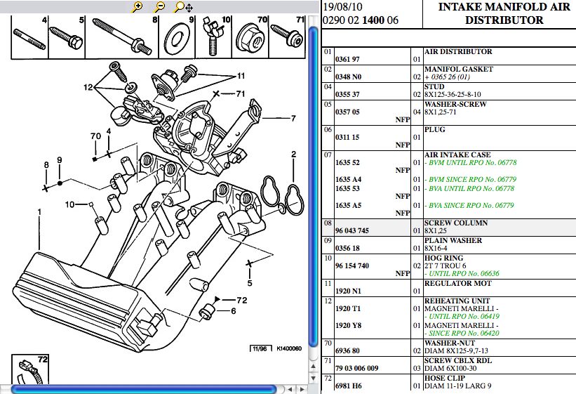

I'm guessing I'm concentrating on item 11 in the diagram below?
Andrew
