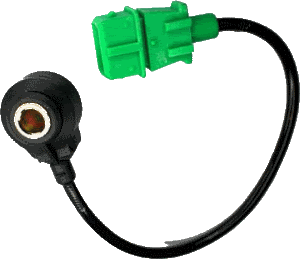

I have seen knock (pinking) sensor in ebay list and I noticed that I have no idea where it is connected :-k
Can you describe the location please?
Pic of the sensor from ebay,

it will be fitted on the front of the block , usualy obscured by the inlet manifold or ancillaries.

no, only petrols, it just allows the ecu to run with the ignition so advanced its always on the edge of pinking but not quite it also means you can run a lower octane fuel without risking detonation. if pinking or pd starts the knock sensor detects the vibrations and turns them into an electrical signal to tell the ecu to retard the ignition timing.
Very clever use of old technology as the sensor is just a very sensitive low output piezo ignition really.

Xantia petrol engines discontinued the knock sensor in very early 1999. The plug is still on the harness, but no provision made for it in the ECU software.
Mine is like this; I've wondered what might happen if one were connected in. :lol:

They went to feedback from the sparking circuit. It's apparently seen as a better telltale of prevalent conditions inside the cylinder.

The sensor is in fact a piezo microphone and it really does listen for a knocking noise!
Adam, I'm surprised it was deleted on later models...
Fact is, running an engine with the ignition advanced as far as the prevailing conditions will allow helps both with power output and and fuel economy. The knock sensors allows that and goes a way to explaining why an engine so equipped runs a little better on premium fuel...
