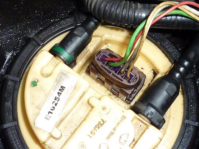

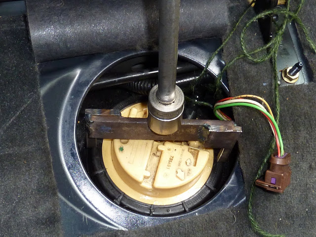

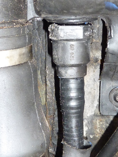

Hello,
I had exactly the same experience as you when I went to fill up for the first time. Turned out to be sender/ fuel pump unit seal which is easily accessible under the rear seat. Previous owner was kind enough not to let me know. Some faffing around before I came to that because I also found two leaks on one of the lines from the filler point to the tank. The first leak was at the connector situated under the wheel arch(image1). This is a ‘push and twist’ connector with a single ‘o’ring (not shown on the Citroen dealer parts diagram). I carefully degreased the connector parts and reassembled using Hylomar. The same line continues round under the arch, nicely positioned for underside damage and disappears in the direction of the fuel tank and is made of some flexible type of plastic. This was also weeping from a split so I chopped a section of it out and let in a section using fuel hose. A word of warning. Some people advocate the use of a screwdriver or a lump of wood to drive the sealing ring undone. It was never designed to recieve that kind of treatment so try to make yoursef up a tool to put even steady turning force on the ring (image 3) and thus cause no damage. Ring undoes CCW, seal is shown as dealer part 153124 and costs around a fiver. Hope this has been of some help. Tool available to borrow if you want.
Regards, Alan
Regards, Alan
