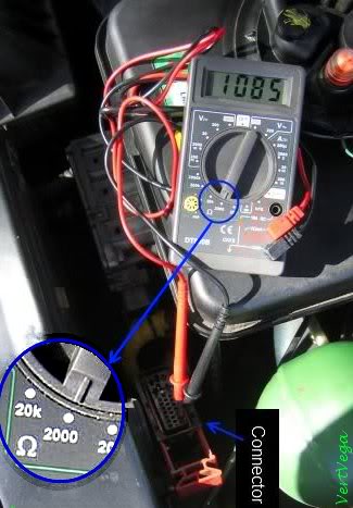

i³ if you have a basic voltmeter, start by measuring the resistances from the connector (pic. below).
A pic of pin assignment on the connector is found in FCF, both for MK1 and MK2 models.
I don't have one at the moment, otherwise I would have sent.
Measuring is simple as seen in pic. Good ABS sensor will give readings
between 1060-1100 ?.
