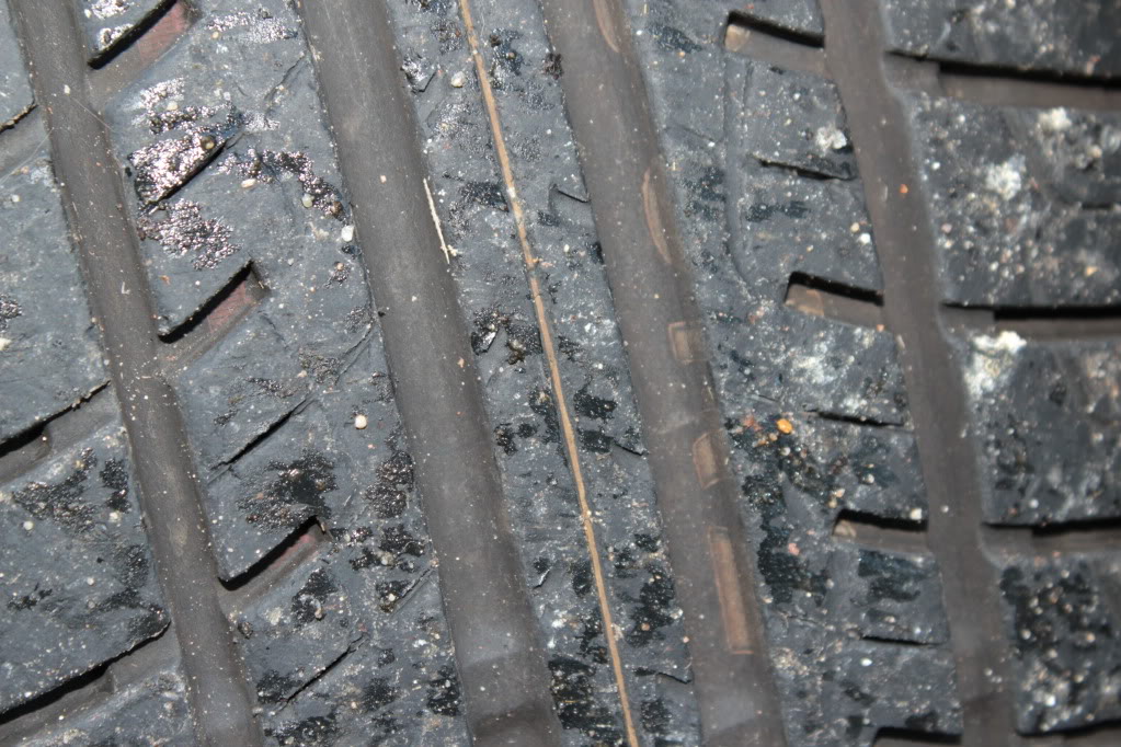

I have just been out for a short drive in the 406, I thought the car felt a bit odd (sorry can't define what I mean) at the front left, I had a look at the front left tyre when I got back, and noticed there is a yellowy brown line running right around the centre line of the tyre, between the very middle two treads.
There appears to be sufficient tread left cf the check marks (probably 4 or 5mm all told) I haven't checked the pressures although I find they hold pressure well and visually the tyre doesn't look low on pressure.
I compared it to the front right (same tyre make and model) and the line is not there. The tyres are Nexen CP641 195/65/R15s. This mark doesn't seem to be dirt, it was visible on all the tyre I could see and I couldn't make a mark in it with my nail.

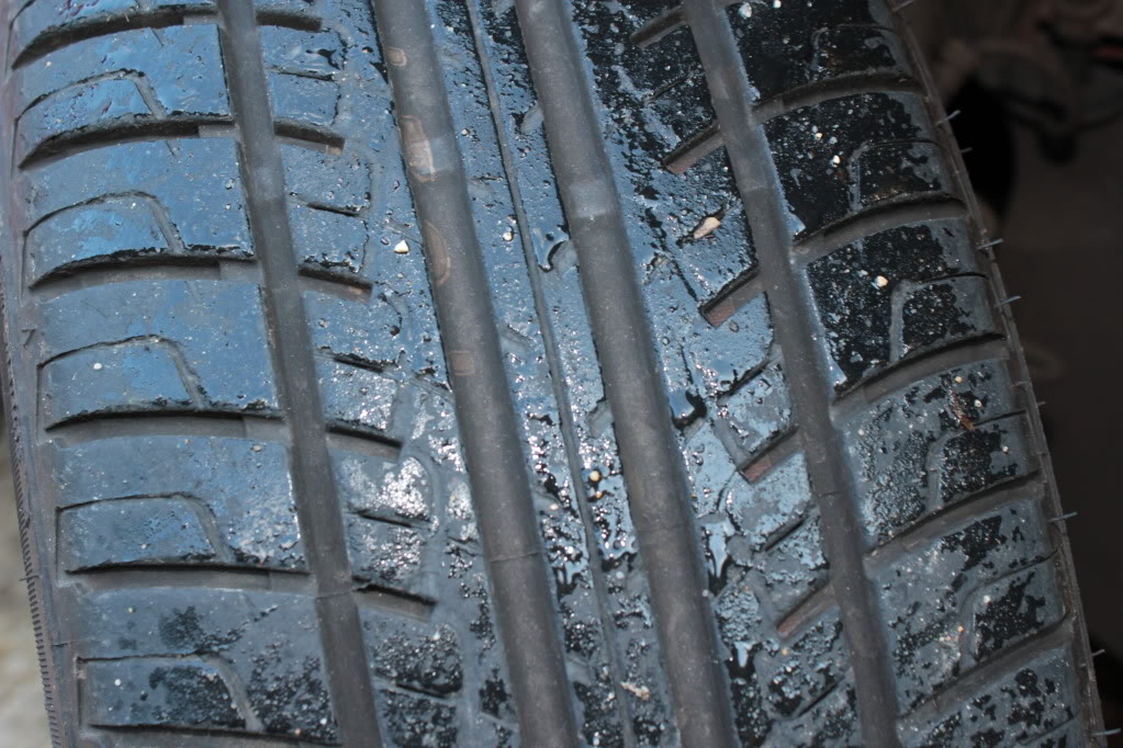

In the UK we can go down to 1.6mm of tread, so a low tread indicator doesn't seem likely, but this is why I'm asking 'cause I just don't know. Unless it is a european indicator perhaps?
The line is even and as far as I can tell covers the whole circumference of the tyre.
I've just taken a couple of pictures in case they may be of use.
Close up of the line.
More general view of tyre.
Other front tyre for comparison.
As you suggest I think I might be giving a local tyre place a call tomorrow see what they reckon.

Yeah I remember seeing these sort of marks on brand new tyres, but these aren't by a long way, they have been on the car probably about a year and a half, although have only done a few thousand miles as best as I can work out.
Yeah I know the normal wear indicators are the little blocks, just wasn't sure if the line may be a different sort of indicator, or if it is an indication of a problem with the tyre.

Our Peugeot has those Nexen CP641 tyres on the front too, they also have the yellow band in the centre, they are warn a similar amount to your tyres there.
Its just a manufacturing line which hasn't worn off as that part of the tyre wont touch the road until its worn past the centre grove.
Ive not felt any problems with the tyres while driving it, despite them being quite shocking tyres for grip, they feel fine, not odd.
They appear to be very stiff tyres, when we got the Pug the pressures all round were only 20PSi, not the recommended 34, but they didn't look soft at all.
