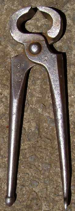

I used pincers like these for years:
but I believe these are the in thing?
Boot Clamp Pliers
Even so, after nearly 30 years of messing with cars/clips etc, I forgo originality and find tie wraps to be far superior...even if they are pence!
