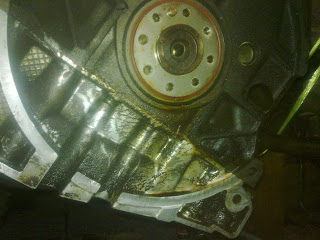

my PUG is 2. L petro.
i have no experience removing it;
i found that it is about 600 Baht (14- 15 Euro)
i think i will replace but no idea to remove.
please:D

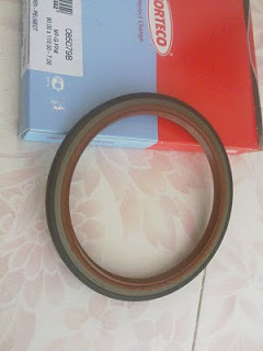

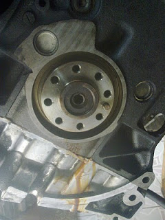

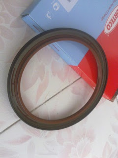

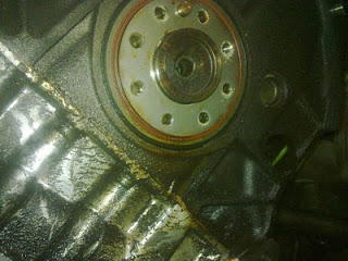

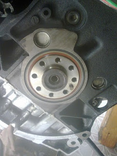

i bought the new one with 290 Thai baht. then i could inside
Front
Back.

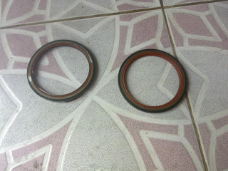

Then, i used the cutter, screw driver and what i could find.
the old and new one.

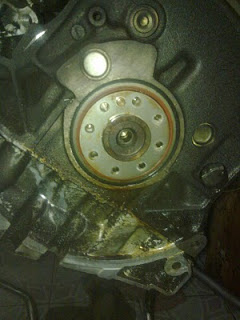

i used rubber hammer. to get it back in the position. the old one can be used to support to get back.
