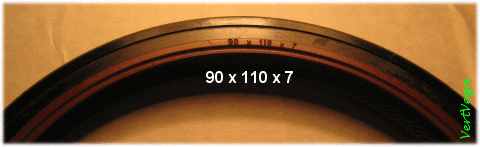

If it is the same oil seal (90 mm) leaking then be prepared for several hours of work until you reach the seal.
Gearbox down, clutch assembly and fly wheel off ...
I just checked from ebay: Xantia Crankshaft Oil Seal Large Flywheel End --> £10.00
I would suggest that you change also
1. transmission oil. If it's manual gearbox 2 liters of Total BV 75W80.
2. gearbox oil seal, another £10.00
