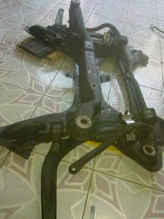

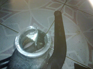

there is a gog gog noise when the PUG run on rough road.
because of i moved down the GearBox. it need to completely remove the suspension. then, it's the right time to manage the problem.

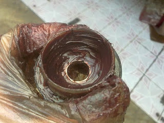

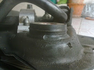

sorry Big picture a gain.
i removed by metal saw cutting.

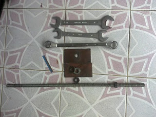

Unread post by toh »
and then clean it
these all tools for this job.
1. the big wrench it 32, the other two are 16 and 16.
2. 2 metal plate with M17 Hole
3. Spiral Axe M16 with 2 Nuts.
4. a few washers.

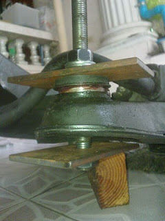

This is very useful "Hand made Hydraulic"

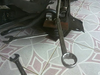

the below wrench is 32 i putted in to the gap as in the picture above.
