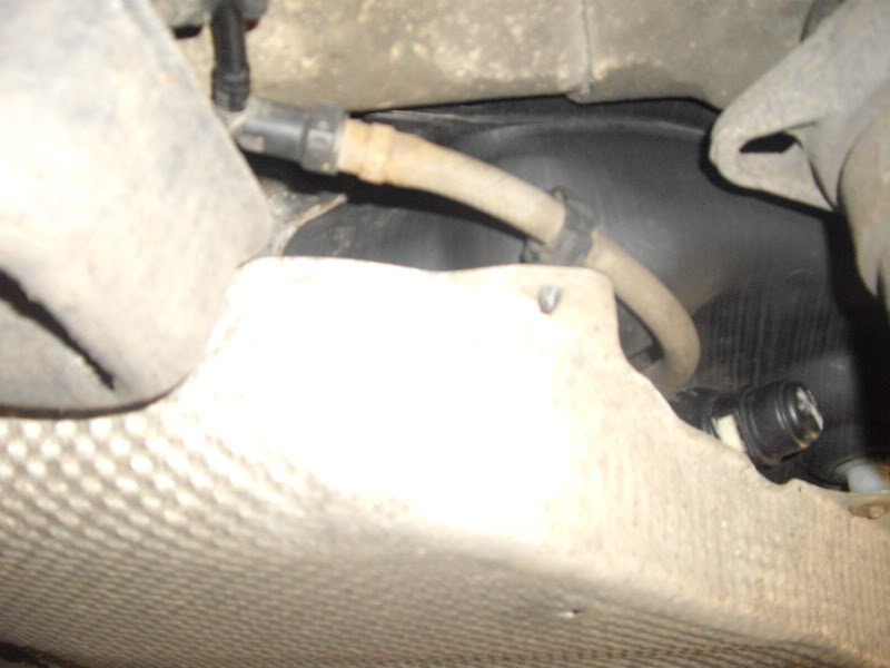

Don't connect to either of the two pipe sockets actually on the tank.
I've just nipped out and took this photo.
In the pic below the connection point is the joint in the pipe at the top of the picture. Connect your top up kit to here.
Remove the overflow outlet cap on the right. The one with the white markings.

Much appreciated kev. thank you - Looks slightly diffrent to mine but ill have a good poke around now.....
Many thanks - great info
Oh joy- Job done, Found the fill pipe sandwiched between Eolys tank and fuel tank so its obiviously been off before I had it, all reconected and tank filled with 3.5 lts eolys, Thank you for your time and effort.
Just a quick footnote to this thread its been well over a week since I filled the eolys tank and one result of it is that it seems to have cured an intermitent problem I have had for some time of the ESP/ASR warning coming up when you first started the car, stopping it and restarting it after 30 seconds normally put it out. No other warnings came up with it. but after filling the tank - no sign of it. Coincedence or fluid level ?
