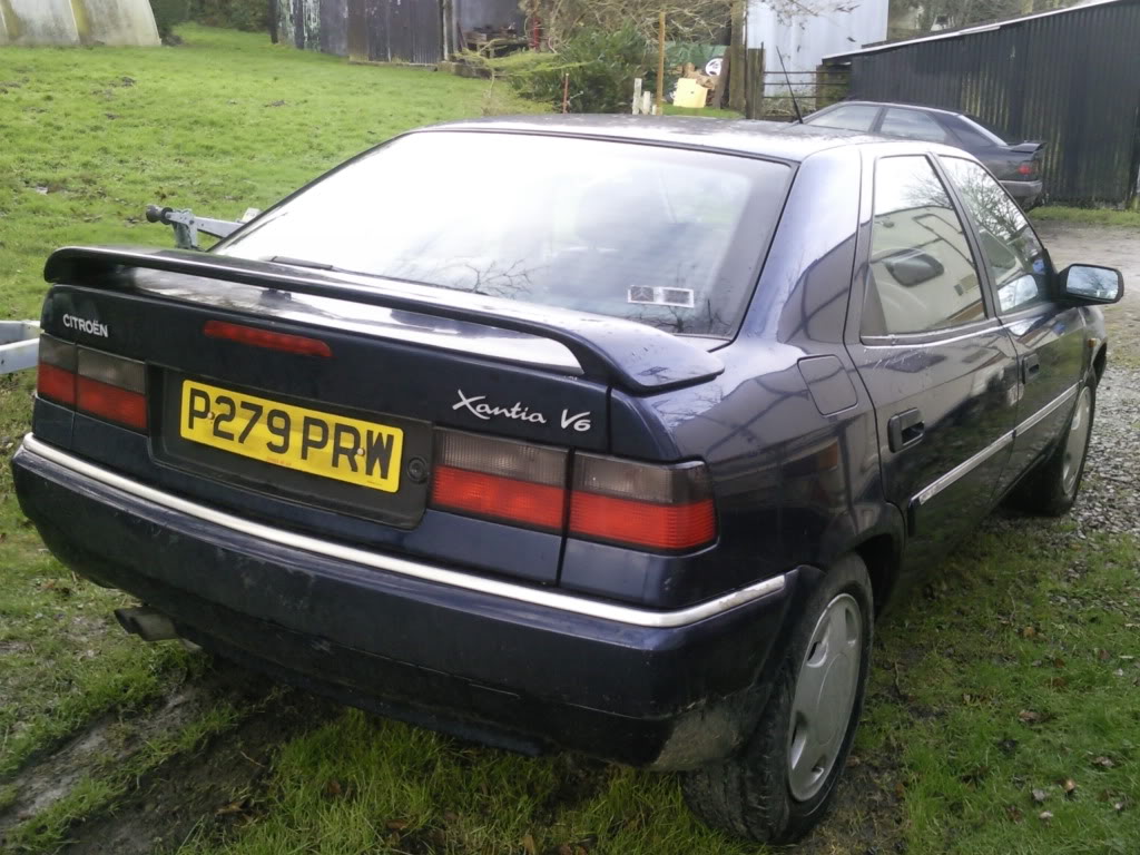

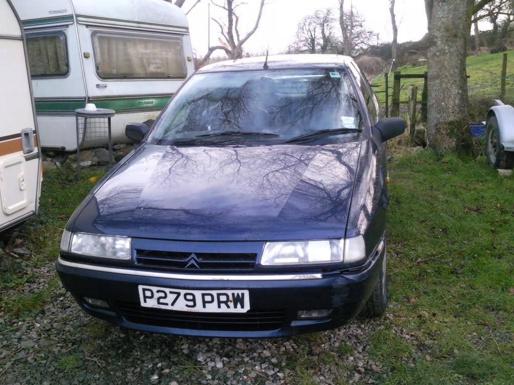

Right, Ill be starting working on my V6 in small dribs and drabs now - as and when I get chance inbetween all other things that go on!
Most will know, I bought a 1997 P reg Martious Blue xantia V6. Needing, 3x ABS sensors, damaged front bumper repair, lower engine mount replacing, passenger door mirror seeing to (Doesn't work at all), and a cold running misfire seeing to, and front suspension feed pipes replacing due to rot in them. Ive also a spot of rust comming through on the Rear arch panel - right in the middle!
I have got ready the Passenger door mirror, front bumper, lower engine mount, replacment suspension pipes, air con stuff, passenger door mirror, and ABS sensors...
All I need to do now is get a damm move on! LOL
I shall get a couple of pictures up soon.
Paul

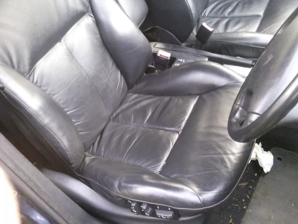

For everyone else who does not know, when we inittially saw the car, there was a smashed rear passenger window, no wiper blades, no passenger front indicator, a damaged wing in accordance with the bumper, a blowey exahsut - ok, slightly, 4 bald tyres.... but I saw through that and decided Urgghh, I do NOT want green, it has to be blue, this is a nice car, also had the full leather instead of that awfully thin sude..!
