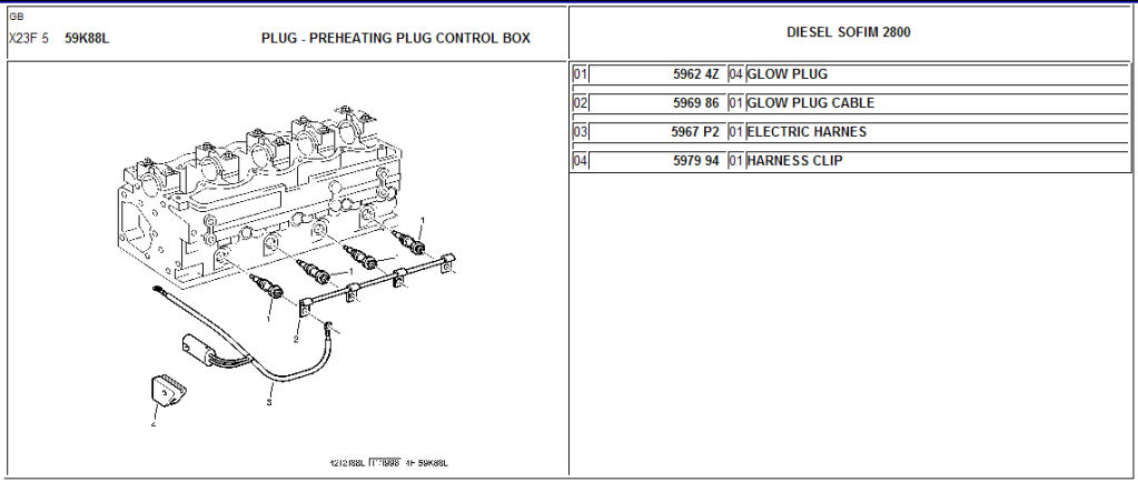

Does appear to have them.
Cannot tell if front or back ( ! ) from this pic though, knowing a few annoyances about these commercials (such as excess unbolting to change a headlight bulb!) , I would not be surprised to find them at the rear of the head (sorry)
This is the only 2.8 engine pic I have, it is a Boxer but should be the same:
'DIESEL SOFIM 2800'
'DIESEL SOFIM 2800'

Its probably your fuel filter and fuel pump you are describing.
The 'single' part is probably a sensor of some description.
The parts near in the head end of the metal pipes are the fuel injectors themselves (do not remove!)
I've never seen this engine that I recall though so cannot be sure, I do think as above they are around the back of the head though.
Looking at the diagram, quite low down on the head too (so if you imagine where the injectors are but around the back) about an inch or so lower than that (but at the back)
Sorry that's not a lot of help.
Andy.

Should be four. Will be above exhaust manifold I would say.
Trouble is I have never ever seen this engine (and HDi's were 'brand new' almost) when I left so I cannot be sure what is where, sorry.

I've just looked on Citroen Service, and there's 'no document found' for engine pre-heating, where glowplugs are usually listed, for your engine. An optional cold start device (intake air pre-heater) is shown, though, and is presumably fitted for cold climates due to the lack of glowplugs. This seems to correspond with a relay, function unspecified, whose part number differs for cold and very cold climates.
Why do you believe that the glowplugs (if fitted) need changing?
