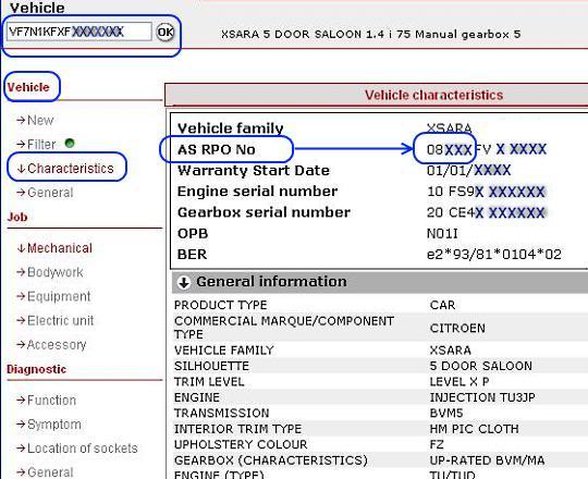

VertVega
Posts: 1178
Joined: 01 Nov 2008, 19:39
x 13
Unread post by VertVega »
RP number (5 digit number starting with 0) should be printed on the tyre pressure label inside the driver's door :?
Anyway citronut you can get it from service pages :)
- Login to service pages
- Enter Vehicle VIN number (In Xsara it's seen in lower part of windshield)
- From left side of the window, click Vehicle --> Characteristics
- you'll get a long list of Vehicle characteristics on the right side of the browser window
- Second line from top, will show the RPnumber: AS RPO No --> 0xxxx
Hope this helps 8-)

Posts: 1178
x 13
frenchcarnut wrote:Couldn't find it on my van, ended up contacting Citroën HQ a few weeks ago to get it.
Here's another way to learn your car's RP number and lots of other detailed information 8-)
Thanks to Citr Service who provides this opportunity.
Below sample is from a Xsara:
