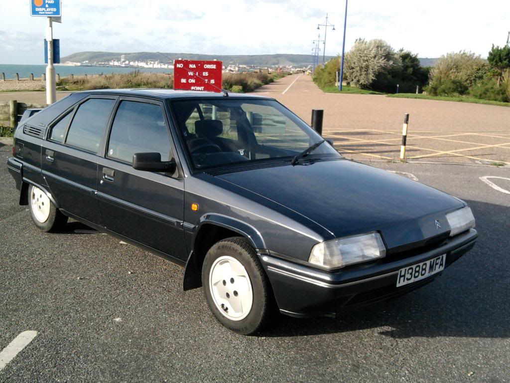

Hi all
Just thought i would post some piccy's of my daily hack !!
Just having sold my XM TCT, in the search for a deisel one, and come across this at the last minute, stuck a bid on and won !!!!
Full Citroen s/h up to 94k ( cambelt changed) now showing 99k,
MOT'd till next July, And Taxed, :lol:
Image Bargin !
Lot of car for £300, it's got a few area's of rust, but nothing major.

1.9td conversions are super simple and theres NOTHING to it... its essentailly a 1.7 block and head but bigger bores, so I cant see what the problem is fitting a 1.9 td in...
Athena spec is nice, gti type with the 3 spoke GTi wheel which I had on my TZD Turbo..
Looks good Nigel, whats the rear arms like??
Have the car running, and then stand a few meters behind the car and look at the rear wheels, they should be DEAD vertical! Any lean in at the top idicates rear arm bearing failiure or wear... an ok job to do if your tool handy.. :wink: :)

That looks like a very nice car but unless I'm mistaken the N/S/R wheel looks to be at an angle, look at the car from behind the wheel should be vertical if its not then the rear arm bearings are overdue replacement.

Yep your all right !!
Had the car yesterday looked over by Citronut ( malcolm ) , and yes conformation of new rear arm bearings, two new shperes and possible front ball joints, so gunna get the parts on order, and as he only works a couple of hundred yards up the road from where i work , and he has the workshop ,il'l get him to do all the work. :wink:
Really smashing guy, very helpful, and rightly so knows all about them,

Nigel,
Re: top photograph, is that the Langney Point Poo farm in the background? :D

Hi there
Yep it sure is, the legendary poo farm, just round the corner ! ( if youl'l
excuse the pun ) from where i live.
Good to know there is another forum member close , i thought i was all on my own down here :lol: :wink:

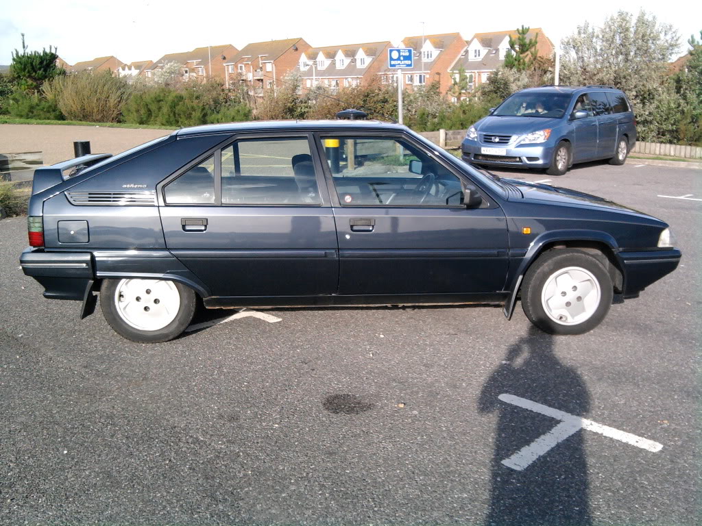

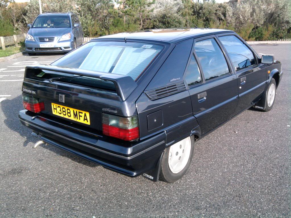

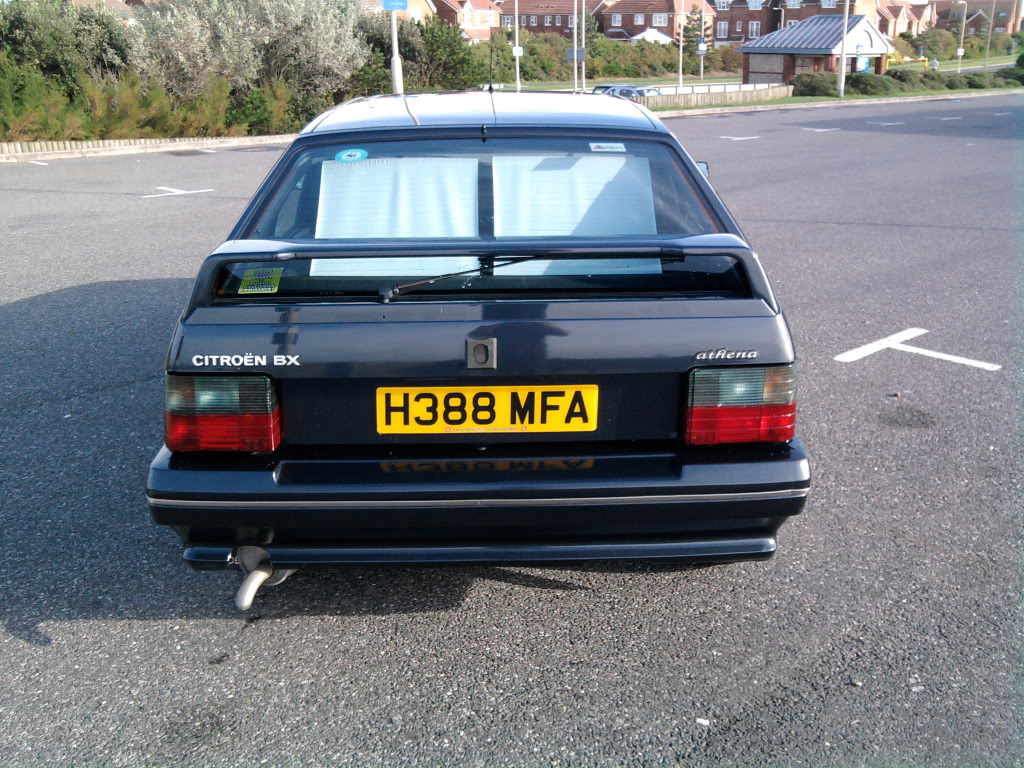

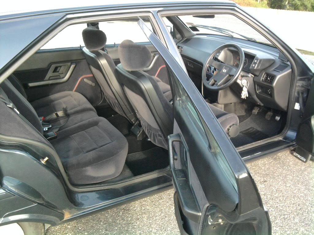

Here goes !!!
Yes the exhaust is hanging a bit low , due to the bracket it supported by is shot by rust !
Thats about it for now, it off to Malcolm's tomorrow for the once over ..

Do you buy your poo from the poo farm? Nice to get it fresh :)
Why is that sign in Welsh?

Its not!
It says: NO UNAUTHORISED VEHICLES BEYOND THIS POINT
