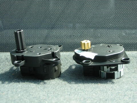

In the photo below there's an aircon flap motor with a long splined shaft.
The standard motor is the one on the right which has a short spline.
The motor with the long spline is a mod and can be fitted if the splined hole in the flap chews up and the flap stops working.
So, does anyone know where the long spline version can be purchased. Citroen tell me it's not listed on their system.

The long splined motor replaces the short one, and may have the same part number, :? but the old short ones have to go first. :evil:

Judging by the plastic mouldings in the picture, it's not just the spline that's changed, the insides have been re-engineered as well.
Are they from the same OE manufacturer (Valeo?)?

Trawling turned up this number: 00006447TK

Yes its part number 6447 TK (for automatic A/C & upto RP no 9940)

The new motor 6447 TK is £69.01 + vat from Citroen main dealer.
I've ordered one.

Long spline motor fitted and the temperature control on the passenger side is now working properly.
