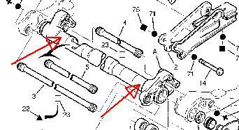

The needle roller bearings you'll find on the trailing arm shafts when you pull them out of the beam tube...
They wear badly due to inadequate grease and can collapse and in doing so damage the beam tube and the trailing arm shafts.
This is not perhaps the very best diagram but it shows the beam tube, the trailing arm shafts and the bearings along with the torsion bars. the red lines are suggested locations for grease nipples...
