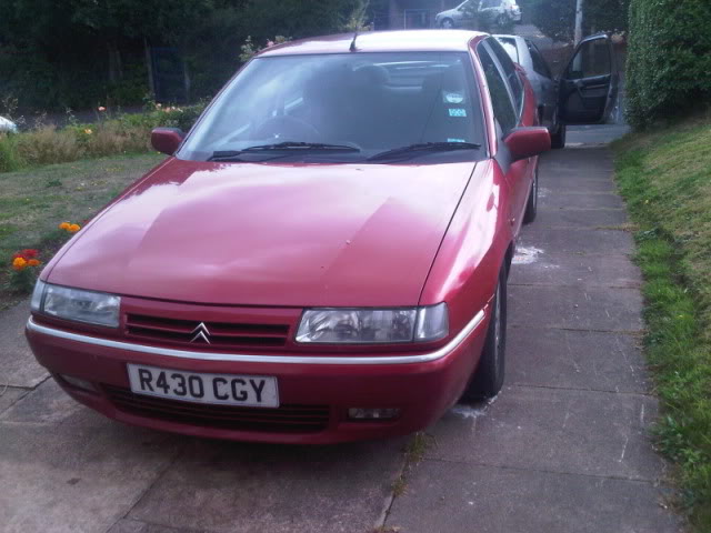

Ok.. Just had a look, took video camera with me for evidence gathering...
Not a sign of a problem, started up STOP light went out pumped the pedal (brakes were hard) no flashing STOP light! No leaks, LHM at Max my hearing isn't good enough to hear accumalator ticks over a 2.1 Diesel knock (V6 Rocks).
So, all seemed as it should. However, the car is normally parked on a sloping drive, could this have an affect?
