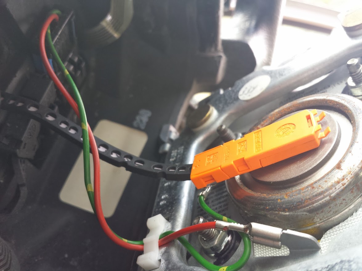

danny13
- Posts: 39
- Joined: 29 Jan 2012, 11:19
Re: Xantia Airbag Removal
Does anyone know how to disconnect the orange connector, it looks like its firmly attached to the metal plate at the back of the airbag and I've trying to avoid breaking it, should it split in the middle (with a bit of brute force)?
