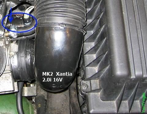

admiral51 wrote:...This could be taken apart and cleaned but i have no idea where to look for ...Colin
Here -->
It's fixed with two torx screws (T20 key), one of them is marked with arrow in above pic.
I have always removed air filter box which makes ICV removal much easier and also
you can reach the lower screw better then.

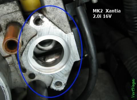

admiral51 wrote:... is it cleanable... Colin
I use brake cleaner to clean it.
Try cleaning it first. If it doesn't help then you can buy a new one.
Also spray some cleaner here, into the cavity -->

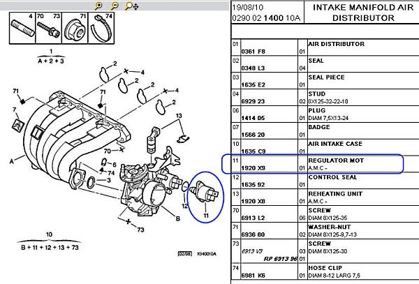

admiral51 I've logged in service pages and entered your VIN number.
I got exactly the same picture as in my car ! :D
Thats' good news because in that case you'll not pay so much for the idle motor :)
Check it from service pages like this:
-Login and enter your VIN number and press OK.
- From left side find Job and --> click on Mechanical
- From right side find Engine section and click on air and fuel supply
- You'll get links below for document pages
- (Lower part of the window) click on INTAKE MANIFOLD AIR DISTRIBUTOR link
- The part number is 11 in the pic. Part 12 O-ring also belongs to it.
You can find from ebay --> ebay: Xantia +idle
and the picture:
