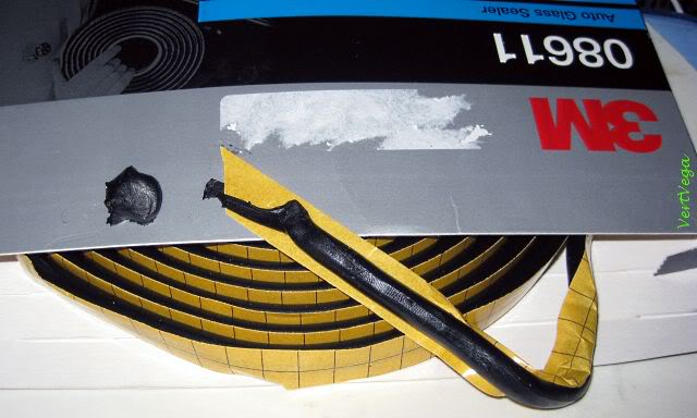

That's true! Membrane must be water-tight, how do I knowOld-Guy wrote:... It's essential that the tailgate membrane makes a perfectly water-tight seal all the way round. The best stuff is whatever Citroën originally used (anyone know?), ...
This is the sealer which I used. It proved to be excellent!
I had to open the membrane several times (lock and wiper motor) and the same sealant is still fine.
Here's a picture of the 3M roll, prod.no 08611 Cordon Butyle Collage Pare-Brise

Oh! Oh! where did you buy that from and how much was it?VertVega wrote:That's true! Membrane must be water-tight, how do I knowOld-Guy wrote:... It's essential that the tailgate membrane makes a perfectly water-tight seal all the way round. The best stuff is whatever Citroën originally used (anyone know?), ...![]()
please tell

back when I had an estate and also had the same problem, I resealed it with W4 caravan bedding mastic, the stuff used to bed joints and awning rails on touring 'vans.
It comes in rolls in the same way as the 3M stuff shown by VertVega and is very readily available from your local caravan dealer.

Here's one link from UK with the Price: £19.70 for a 10 m roll --> 3M butyl-strip-sealantcachaciero wrote: Oh! Oh! where did you buy that from and how much was it?
As CitroJim said there are similar products available on the market and they can be even cheaper than this one.
I think the best part of this product is that it is a roll and can easily be formed (like a Bostik Blu-Tac).
After several opening/closing of membrane, it stayed as a good sealant
